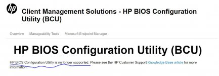

Hi, i need to do this but HP dosent support bios configuration tool anymore, can you send me the utility file please.
