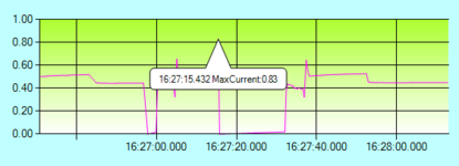

Hi! I think I need this bios repaired /Clean ME. I tried every bios file from here:
and here:
those are not working. I attached the bios file and a picture with the current consumption witch I think that represents a bios issue. (powers on goes throw a boot sequence and remains at 420-ish mA)
