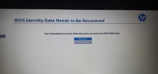

this file good butt arar kming plese remove arar
Use this procedure to reset the CMOS and recover the BIOS.
  • Turn off the computer.
  • Press and hold the Windows + V keys, and then simultaneously press and hold the power button. ...
  • When the CMOS Reset screen displays or you hear beeping sounds, release the Windows + V keys. ...
  • Press enter to restart the computer.

not solfe arar prablme
